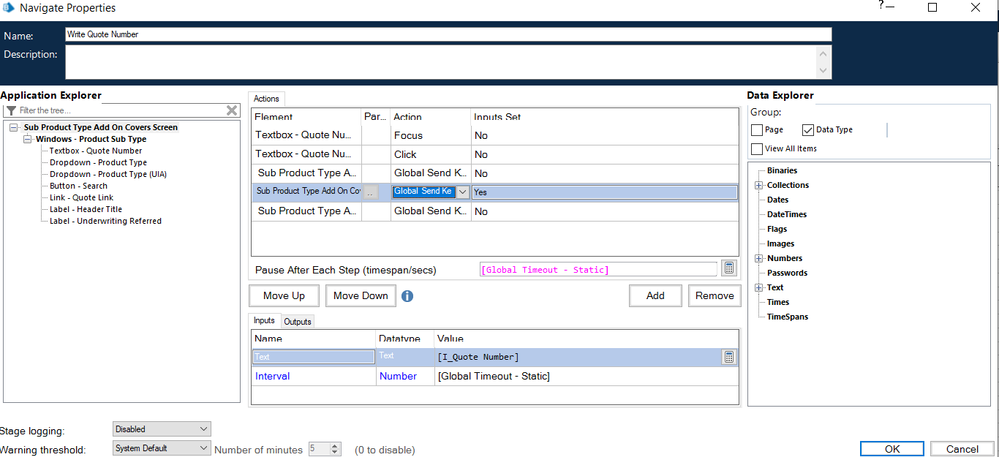

Hi Petr,
This happens when the web text actually doesn't really gets set up in the element properties. It might seem to you that it's written but the value attribute of that element actually doesn't get set. This happens a lot when using writer stage. In such scenarios, your workaround can be to use a Navigate Stage instead, there you can click on the element where you want to type using the 'Click' action on the element where we need to type. Then you can add another action in that stage where you can use the 'Global Send Keys' action and send the text as an input for the root node of the application modeller. Please find the below screenshot for more details:
So here I have used three Global Send Keys action as you can see on the root node, where the first action is used for clearing any content that already might be present. It is optional. For this you can send a simple command like:
"{HOME}+{END}{DEL}"
This is equivalent to Home then press Shift + End and then press Delete.
Second command is the where I send my text and I am providing a delay of 0.2 seconds to make it stable.
Third command I am sending the following text:
"{TAB}"
It will be equivalent as that of pressing a Tab character on keyboard.
Using Global Send Keys, you can perform the keystrokes as that a person does manually. This should work in your case.
