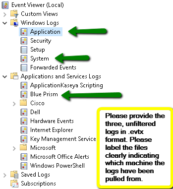

I think it will be better to open a case with our technical support team.
It will be helpful to provide the windows logs to analyze what is happening with the system.
