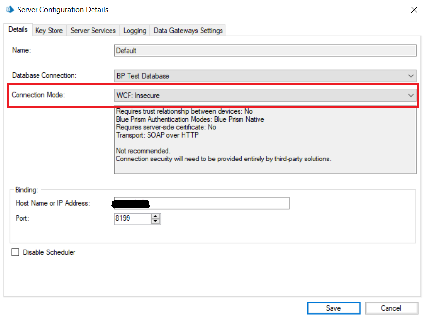

You mentioned that the runtime resource is configured for .NET ​Remoting: Secure as the Connection Mode. Can you confirm that the Application Server is also configured for .NET Remoting: Secure as the Connection Mode? The two must match. Below are some screenshots of a config. These are based on WCF, but the same idea applies to .NET Remoting.
Runtime Resource Example Configuration:
Application Server Example Configuration:
