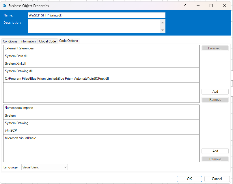

Current configuration is as below, I've moved the winscpnet.dll and winscp.exe into the blue prism folder.
Registered the dll as a COM library and added blue prism folder as a windows PATH variable.

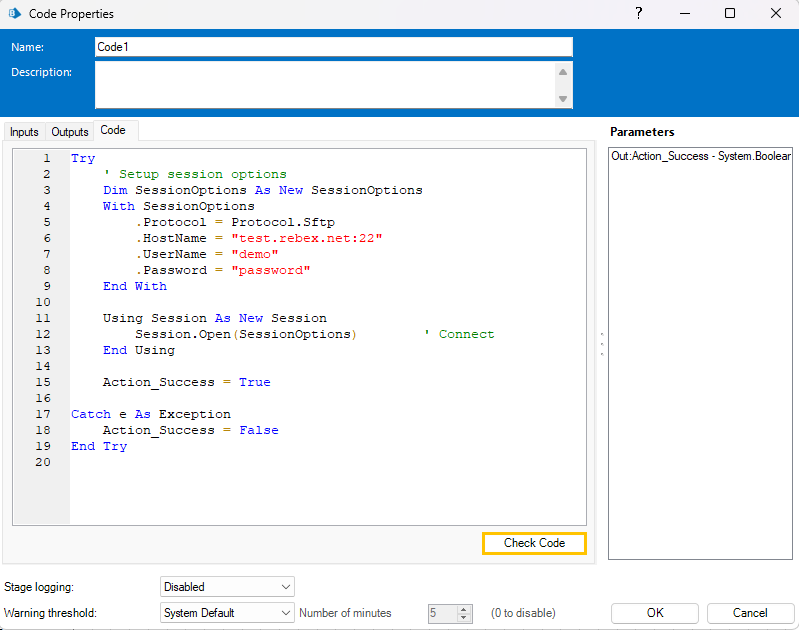

simple code lifted from the docs to create a sftp session to a demo sftp server and return true if connected

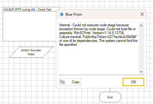

I am presented with the following error, which fundamentally, from what I can tell, cannot see the WinSCPnet library or load it.

Hi Chris,
Have you checked if the dll file is blocked by Windows by any chance.
https://winscp.net/eng/docs/message_net_operation_not_supported
I tried this out in BP 6.10 with no compile time issues.

10-07-23 02:00 PM
@shashank.kumar280 , you are the man. HOURS trying to figure this out and its a windows protection issue.
Thank you and kudos to you.
