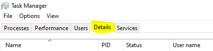

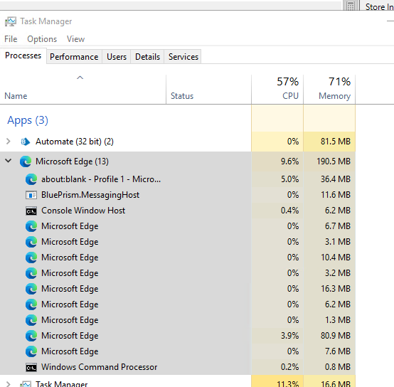

I knew you did plz do once again sing out your machine entirely (all users should sign out if you have a shared machine) don't restart only sign out
Then sign In and open the task manager if any search engine instances are opened (chrome, edge, all should kill plz don't think I'm using edge so I don't need to kill the chrome Plz kill all) might have a chance to run in the background. So plz kill it
Plz check the service worker status (active or not). Also plz check the edge policy, If you can plz provide a screenshot
