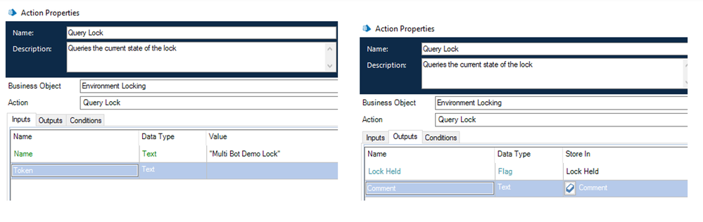

Now coming to it's working, we generally have three types of actions associated with Environment Locking which are: 'Acquire Lock', 'Query Lock' and 'Release Lock'. The way we can implement this concept is by first using the 'Query Lock' action where you provide the lock name which can be a custom name set by you and it will return a flag indicating if any token corresponding to that lock has been generated already or not as shown below. If we already know the randomly generated token text we can put that here though it is optional:

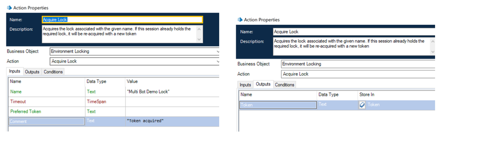

Next we use a decision stage to check the flag value, if the flag value is False then it means that the lock is free so we can use the 'Acquire Lock' action and pass the lock name which will generate a random token value for us till the lock has been released. Here Timeout, Preferred Token and Comment is optional. If we provide the preferred token, then no random token text will be generated. We can provide comments with meaningful values such as the 'Resource Name' which can tell us which Resource had the environment lock during debugging. Preferred Timeout can be used if there is a maximum time that we need for a lock to be acquired. Once the time is elapsed the lock gets released.

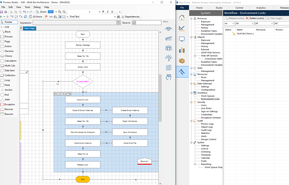

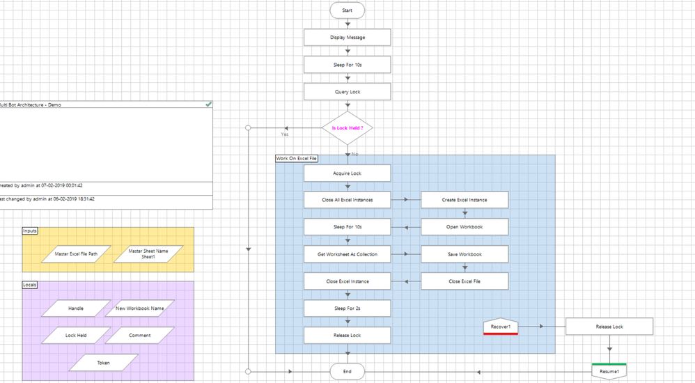

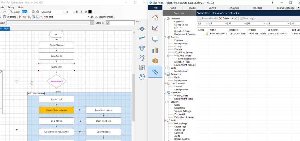

Below is a sample workflow, where we want to read an excel file only suing a single resource. So if this process is run across multiple resources, there will be a race among them which will determine who queries the lock first, the resource who wins this race will read the file while the others will skip this entire workflow.
You can also view the environment lock details from the System Manager -> Workflow -> Environment Locks. The moment the lock has been acquired, you will see the lock visible in the panel as well as shown below:

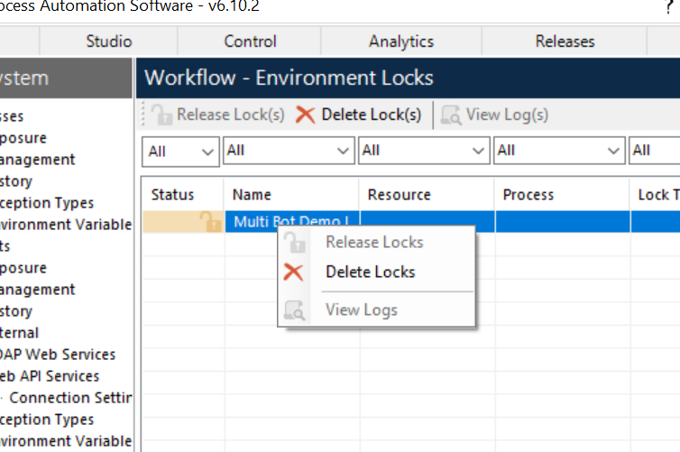

Here you can see the lock as 'Unlocked' since we have released the lock using the 'Keep Environment Lock Flag' as True otherwise it would have been deleted. In case the Resource for some reason cant signal the database to release any lock, the lock remains in an orphaned state which will be 'Locked' only. Such locks can be deleted manually from the System manager as shown below:
