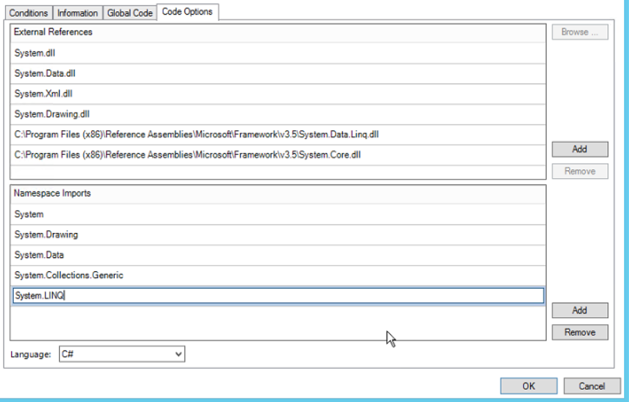

Hey guys,
I'm trying to add LINQ to my object, however, I can't seem to set it up.
The system is using .NET 3.5.
This is my setup. I am getting "The type namespace LINQ cannot be found..." error afterwards.
Thanks in advance.

You shouldn't need to directly reference System.Data.Linq.dll ; the library should pull from System.Core.dll iinstead.
On my end, it works as-is with the includes you've given. You might try calling System.Core.dll without the folder path in front of it to see if it behaves any differently (might reference a different file location/version).
