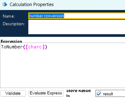

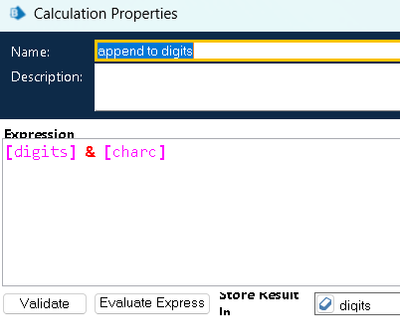

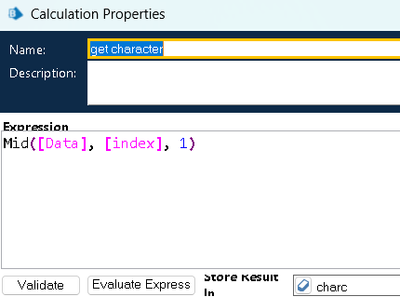

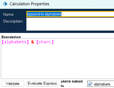

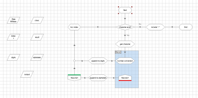

I have come up with another approach where it can be used when number of digits and alphabets are not known.
So, in this approach I am using ToNumeric() function to convert each character of the word into numeric, it works if that character is digit but fails when it is an alphabet.
When it is a digit, I am appending that character to the data item "digits"
When it is character, it moves to the recovery mode where I append that character to the data item "alphabets" and resume it to continue to process next character.

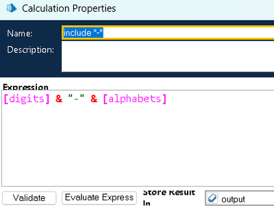

after all characters are processed, on performing:
[digits] & "-" & [alphabets] in a calculation stage, it will give the desired output
