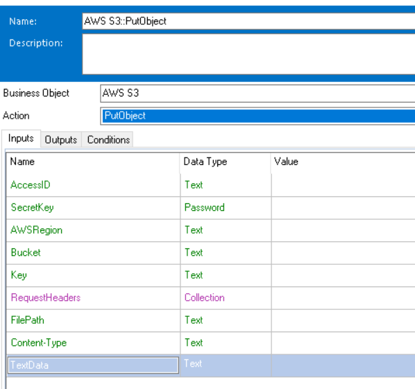

I got the below info from my AWS team and it worked on the postman. I wanted to use the same in AWS S3 Put Object but I couldn't see those parameters in the input values so can you please help me here?
curl --location --request PUT 'https://4thdkc2zq3.execute-api.us-east-1.amazonaws.com/dev/mfgrpafiles/Stellantis_CoC_EN.pdf' \
--header 'Authorization: Basic YWRtaW46YWRtaW4=' \
--header 'Content-Type: application/pdf' \
--data-binary '@/C:/Users/T0003BB/Documents/Stellantis_CoC_EN.pdf'
API Name:MFG_rpa_api
Protocol:REST
S3 bucket name:mfgrpafiles
Env: Dev
Arun
