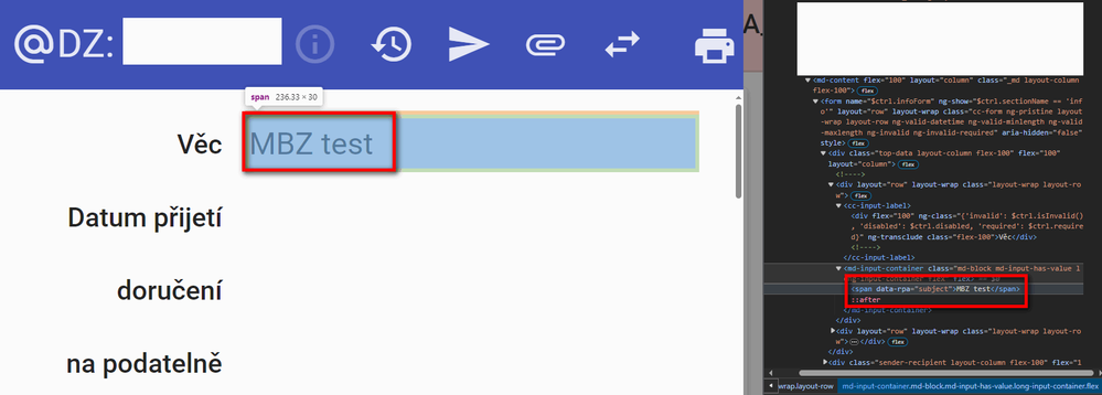

Hi guys,
we use a target web application in customer services, in which IT provided me with a custom development for better readability for RPA.
I have problems with this element because it is a SPAN
<span data-rpa="subject">MBZ test</span>
and I don't know how to set it up in AppModeller (Browser mode)

Hi Lukas if when you spy the element you can't see the 'data-rpa' attribute, you may need to use an Xpath expression. If you're not familiar with Xpath, you can think of it as a special syntax that allows you to put all your element attributes in one line. Try pasting this in the Path attribute and then untick all other attributes.
//span[@data-spa='subject']
There is plenty of Xpath training online and the BP University has a course you can try too.
