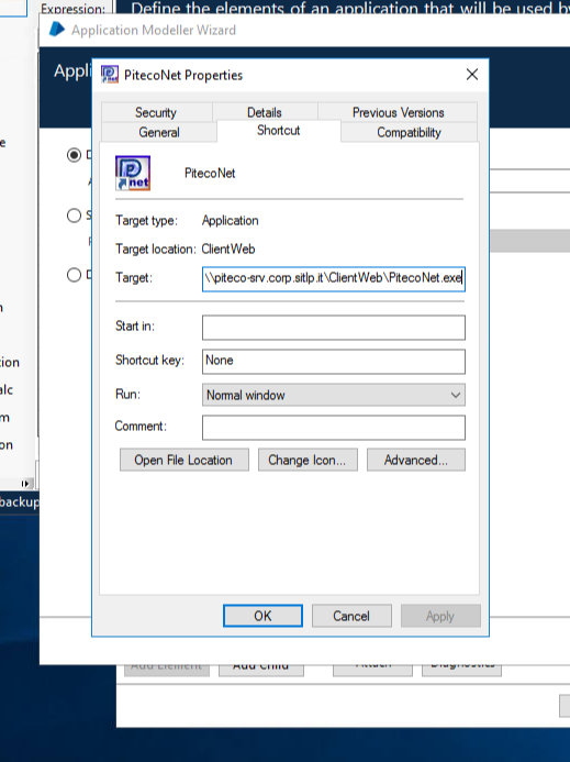

I am struggling with finding out the configuration of the application modeller to work with an app called PitecoNet. The application is not a software installed on the machine but rather a link to a shared network on a server called piteco-srv.
I have tried "Windows application" and "Java-based application" and they both cannot attach to the app even though I specified the process name "PitecoNet.exe" (note that the application will be already running). I also tried "web-based app": with this the attachment works but the elements cannot be identified properly. As identifying method I've tried "browser mode" (no success at all) and "Win32 Mode" (little success).
any help or suggestion on how to make this work in the best way would be much appreciated. I know the last resort would be to use the region mode but I would like to avoid that.

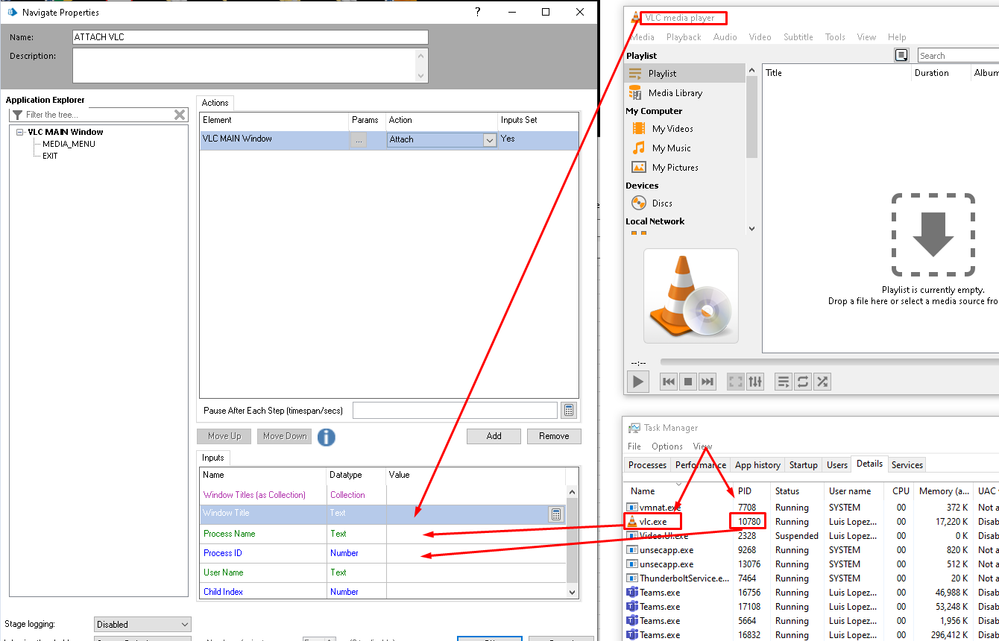

Do you try to attach the application, just select the application is already running, then just attach the application using the information found in the "Windows Task Manager"
Then SPY the main window of your Application using WIN32, this will help you to attach the window, from there just need to provide the info to attach like "Window Title" or hr PIB.

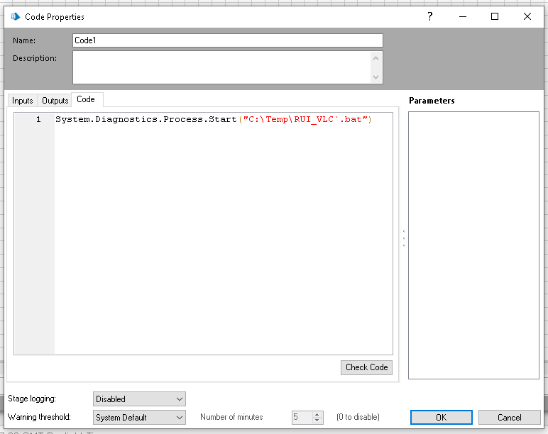

If this works for you, you only need to create a code stage to run the application by using a batch file.
like this example:
I hope this work for you, I tested and work for Me.
