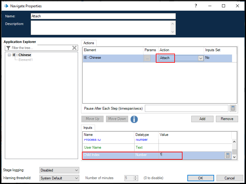

I noticed that there is an problem in Attach action with 2 byte characters (e.g., Chinese, Japanese etc). Until the problem is fixed, please take one of the following approaches.
  1. Set only English part in Windows title if applicable (e.g., if the title was "World 中国", the parameter can be "World*")
  2. Open IE with English title page and attach to IE. Then, move to the Chinese title page.
  3. Use other parameters without Windows Title (e.g, Process Name = "iexplore", Child Index = 1) in Navigation stage.

thanks for the reply., unfortunately...
1) English part is not working as well.. dont know why
2) Could probably work, but its not following our VBO creation/actions separation rules
3) We are using more IE windows, this would not work during the development or debuging when you are testing only one part of the process with 1 IE window(this would be index 0), maybe to create a dynamic childindex calculator with increment if not able to attach, this probably would work.
Still as mentioned above, im using the method of attaching to window based on Process ID. In this case the Chinese is working. You can get the Chinese windows title from the Utility - Environment (Get Memory Stats), but it needs to be modified, then filter out the right Process ID based on the windows title. There is no issue with Chinese Characters.
