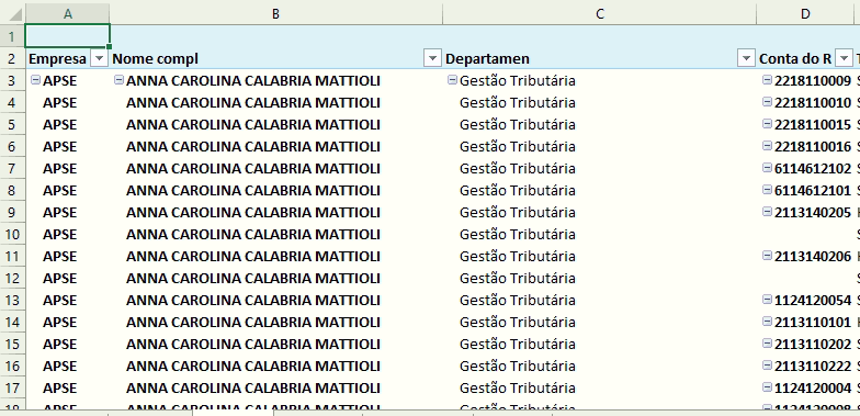

About your question:
The normal table its only a sheet with the column name, and the lines,
This is my normal table:
And I use those register to generate the dynamic range.
I think its not working for dynamic range, because I can't put a filter in the first line
The button get inactive
And I can't delete the first line, because its an automatic table, generate by Excel.
I have tried, with a range, from "D2:Until the end" but also didn't work.
I don't know if my case is clear, if not, I can try explain in other way.

On second glance on those tables, the one you're working on looks to be a Pivot Table, which doesn't use AutoFilter. I get the same error that you are getting if I try to use AutoFilter macros on a pivot table.
I'd suggest using the Record Macro feature in Excel to get a look at the specific code you'd need to run to filter the pivot table to your needs. Any VBA macros can be pretty easily imported into Blue Prism code. I believe the code you're looking for is going to be something like this:
sheet.PivotTables(1).PivotFields(4).PivotFilters.Add2 Type:=xlCaptionEquals, Value1:="611"​
Nicholas Zejdlik
RPA Developer
OMG! I can't believe, it works!
I only had to make some adjustment to get the field I wanted, and use two criteria.
