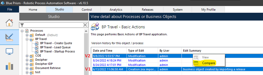

1. Go to the studio dashboard.
2. Select the two versions of your process/object and right-click to enter into Process Compare Window.
Here I have V1 and V2 where I want to export V1 older version and keep V2 intact.

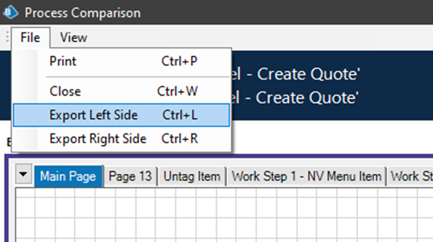

3. Inside the Comparison window, click the File Menu option.
4. Click Export Left Side (V1 - old version export) - Export Right Side(V2 - new version export)
--> The steps are the same for both Process and Object.
--> This is useful if you imported a new process by overwriting and didn't take a backup of the current version.
-->  When someone overwrites your versions and you want to export your work back.
--> This is handy if you need to roll back your deployment in the prod environment in case you notice any bugs after deployment.
