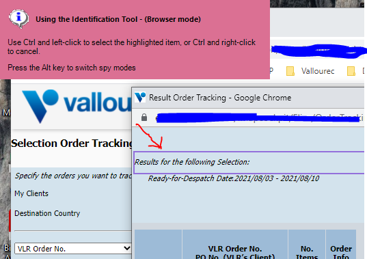

Hello Experts!
We are migrating from version 6.5.1 to 6.10.2.
In our regression testing, We identified that a old Chrome automation stopped working.
The mapping works normally when we are on the main screen of the website. But when we click on a button and it opens a "popup/modal" window with more data, BP cannot spy this detailed screen using Browser Mode anymore. Sometimes UIA mode works (but it means that we have to remap the website... it is a ton of work).
We did many tests and we concluded that the issue is related to the "Use Fixed browser extension port (31924) only" option. When it is unchecked (using ephemeral port) we cannot interact with the popup window. If we flag the option, we can interact with the popup window. However, after some executions, we have faced the "That the browser extension cannot be detected or is not active" error. According to the old posts here, it looks to be a problem that remains since v6.8.
Before that, We've tried to attach just to the "popup window" using the window text without success. We've also tried to attach to different Chrome processes, the Application Modeller still only recognizing the parent window.
Ephemeral port ON (not fixed port) - We can spy the main screen BUT NOT the "popup window"
Ephemeral port OFF (using fixed port 31924) - We can spy BOTH main and "popup" windows.
We appreciate any idea or workaround once we understand that "Ephemeral port" must be the "official" mode for the future versions of BP.
Thank you!
Thank you!
Best Regards,
Flavio Lara
System Analyst
Vallourec Tubos do Brasil
Belo HorizonteBrazil
