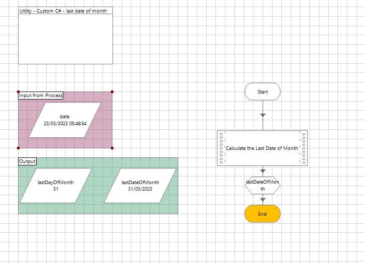

Mukeshh_k

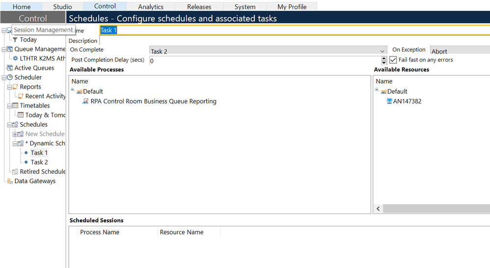

Hi @ParnabSinha_Cho , I assume you can create quick validation process which runs daily during the required quarter- calculates the Today() retrieves Month and Year - Calls an object where it calculates the 1st day of month and give back output as first day of month - it validates the days period less then or equal to <=7 and similarly if it fails the first validation it goes to calculate the last day of month and checks the 7 days difference if it passes as complete - If both of these Validation Fails throw an Exception, else complete the Validation Process> Go to Schedule Create a generic Schedule (Daily) for Validation Process as Task 1 and assign Task 1 - On complete > Run the Actual Process as you stated above as Task 2 and On Exception > Abort.
Example:

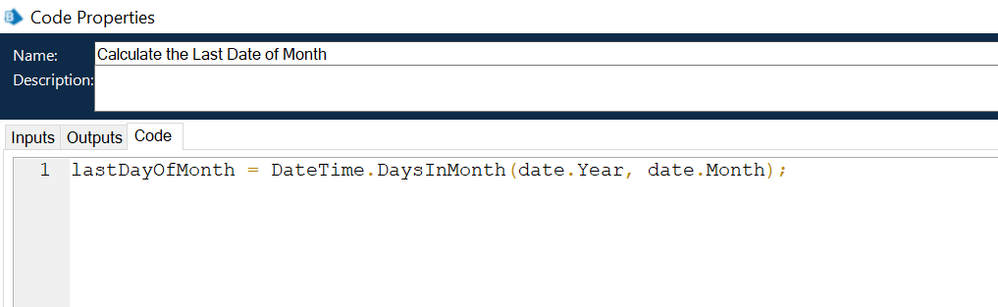

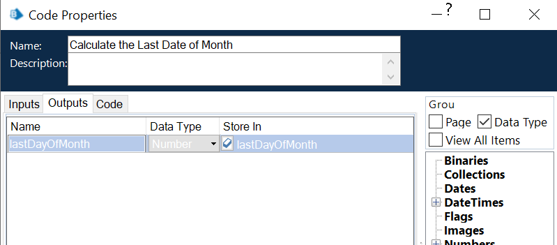

Calculating the First Date of Month is easy as it can replace today with 1st day of the month, to Calculate the Last date of Month : Create a custom in any of your C# object or Extended Object as below :
Input Date : example - 23/03/2023 05:48:54
Set Output: as Number for last Date of Month
Code: lastDayOfMonth = DateTime.DaysInMonth(date.Year, date.Month);

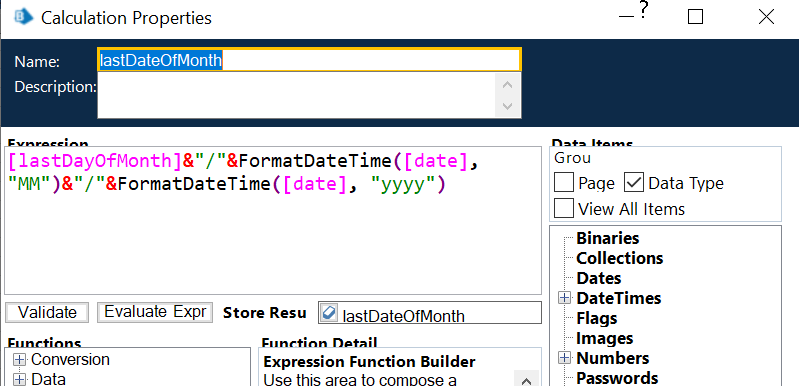

Preview the Last Date of Month in Calculation Stage: [lastDayOfMonth]&"/"&FormatDateTime([date], "MM")&"/"&FormatDateTime([date], "yyyy")
