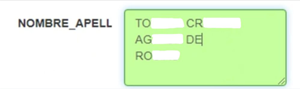

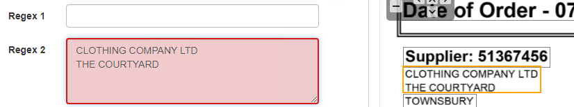

I want to show a wrong behavior of decipher when working with regular expressions.
I am working with decipher to extract information from ID documents, so I covered the sensitive information in all the screenshots I attach. Here is one <document example:
I want to extract the name of the person (all the words covered by white), so the header of the field is "NOMBRE". In order to avoid Decipher to extract the alphanumeric code covered by blue I wrote this Regex:
([A-ZÁÉÍÓÚÜÑ]+[\n ]+[A-ZÁÉÍÓÚÜÑ]+)([\n ]+[A-ZÁÉÍÓÚÜÑ]+)*
The regex makes decipher extract something that has two or more words (with all the Spanish characters, but not allowing number), separated by spaces or newlines.
As shown in the first screenshot, decipher has not extracted the second line of the name (it is a multiline field), so I manually reshaped the box of the field. After doing this the validation of the field fails and the box turns red even though the data should fix the regex.
The way I found to fix this is:
Can someone explain this behavior?
It is not a big deal when doing manual data verification, but I see it can become a big problem if there is a bug with the regex when running decipher in autonomous mode.
Thanks in advance for any help

- Click inside the field
- Modify the data inside (e.g. remove a character)
- Click out of the field
- Now the field turns green showing the data format is valid
- Click inside the field and undo the modification I made (introduce the character I deleted)

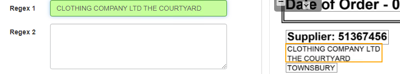

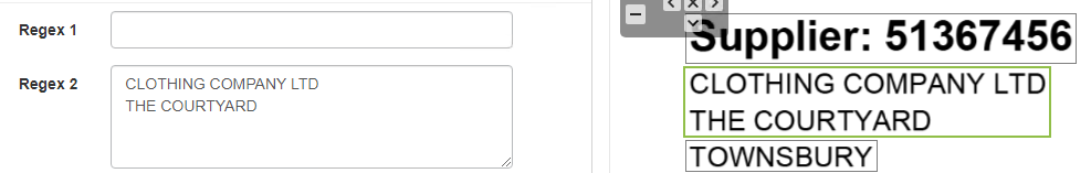

It's due to an interaction between the multi-line flag and Regex for extracting over multiple lines. I deselected the multi-line flag and changed the greedy marker "+" after each of the new line characters to "*" as 0 needs to be an option for it to work.
([A-ZÁÉÍÓÚÜÑ]+[\n ]+[A-ZÁÉÍÓÚÜÑ]+[\n ]*)([\n ]*[A-ZÁÉÍÓÚÜÑ]+)*
Single line field
Multiline field
Give this a try, if you haven't already, and let me know how you get on. This issue has already been raised with the development team.

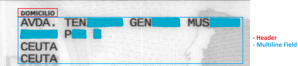

Does the flag help Decipher to choose more than one line of data? After training ~20 documents with the Multiline flag Decipher still takes only the first line of the data.
How can I force Decipher to extract always more than one line if I know one specific field is always multiline? One of the fields I want to extract always has three lines. My original idea was to use a regex that includes as many "\n" as I expect the field to have. Any help with this?
In some document types, each line contains different data and I want to keep the "\n" to know which line is which, but in other cases extracting all the data in one line is 100% ok, do you still recommend using the Multiline flag in these cases?
