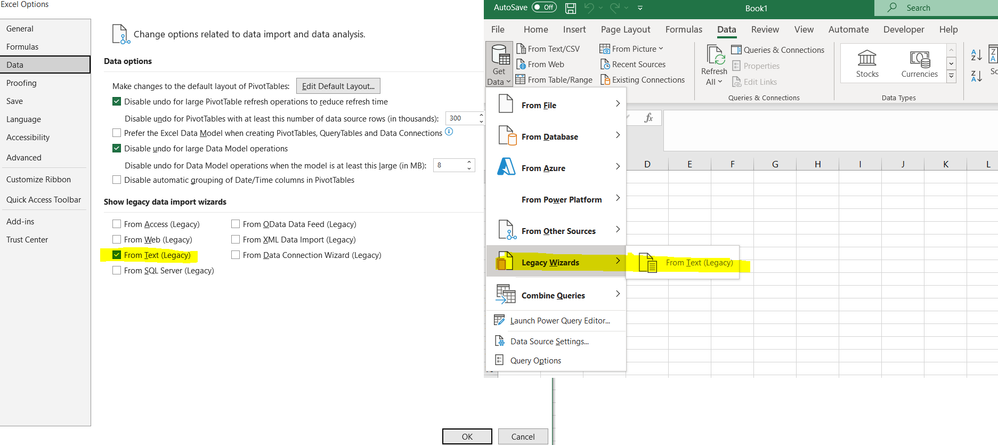

11-08-23 07:03 AM
Hi Neeraj,
If you can attach a sample csv file, then I can help you with custom codes for the same.
Also Neeraj in the meanwhile try to use the Import CSV function present in BP Default. You may have to change the code a bit according to your requirement then it will work. Just record a macro while importing the csv into Excel. You will get the below-attached code copy the same here. It should work. The highlighted one is the code for UTF -8 that you have to change in the existing code.
To get this option in Excel 365 you have to do few changes to get the above code by recording macro. Please see attached image for this,
