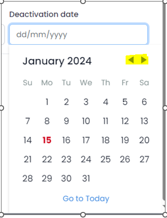

This date will be different for each user account and doesn't have any boxes on the calendar picker to select month or year only arrows - so I'm not sure how to set it up so that it reads the date from the report and then knows how to navigate to that date on the calendar picker .. see below
date on report comes through as below
system has the below box to input date  - it does populate the date in the below box using a write stage, but after clicking submit it doesn't stay on the staffs record.
Therefore I need to use the calendar picker below - as dates can be in various months / days how can you programme the digital worker to click on the arrows in the calendar picker (highlighted) to select the right month and then select  the right date - all from reading the date form the report?

Calendars are usually a nightmare Frankie and you're right to want to stay away from them if possible, but unfortunately it looks like in this case you can't. The date field will have been built to expect human input using the keyboard and mouse, but the Write stage is a non-human technique. Even though it appears that a value has been entered, the web page is 'unaware' that the field has been used.
Before attempting to spy the calendar, I'd recommend experimenting with Activate Window, Focus. Global Mouse Click and Global Send Key/Events. In other words, try to make BP do what a human user would do. Also try adding your date to the clipboard (Utility - Environment VBO) and doing a CTRL V.
