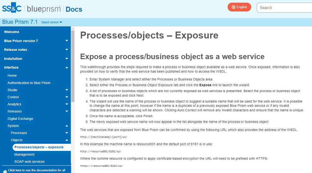

We are on 7.1 so how can we use it as REST? The exposure window under settings looks very similar to V6.
Is there any guide or online documentation available?
The online docs portal for 7.1 and 7.2 talks about the same WSDL setup that uses SOAP13477.png

The BP REST API is a completely different beast from SOAP. You don't expose specific processes/VBOs per se. Instead, you use the API to create a session on a DW and assign the process ID to that session. Then you can issue a start command against the session.
Here's a link to the REST API documentation for BP v7.1.
https://bpdocs.blueprism.com/bp-7-1/en-us/bp-api/api-spec-home.htm
