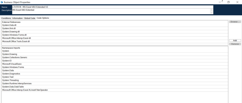

Hi @YunaLee - You are missing the Dll and Namespaces - while recording the macro - The Macro has used few of Excel libraries - you would need to find those dll & references and get it added in your Initialise stage of the code, you can download these dlls externally and add it into "C:\Program Files\Blue Prism Limited\Blue Prism Automate\" along with other dlls  :
For more on these two dll and references which your code is using- check Microsoft documentation below :
Microsoft.Office.Interop.Excel Namespace
Microsoft.Office.Tools.Excel Namespace
Download link for Microsoft.Office.Interop.Excel : https://www.dll-files.com/microsoft.office.interop.excel.dll.html
Download link for Microsoft.Office.Tools.Excel : https://www.dllme.com/dll/files/microsoft_office_tools_excel
Adding it to Initialise Stage:

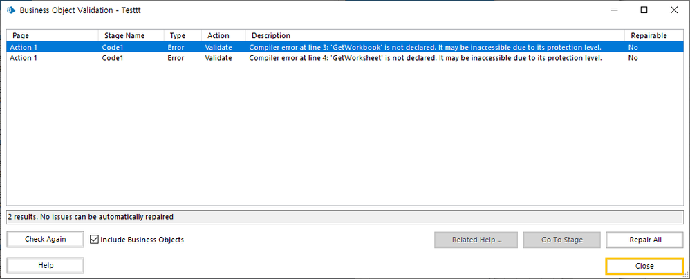

Hi Michael.
Thank you for the reply! xl* related errors are gone.
I have changed the xl*s to numbers as your guide.
But I still get the following erros
29579.pngCould you advise me on this error?
Best Regards
Yuna
Presales Support
Presales Support

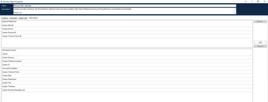

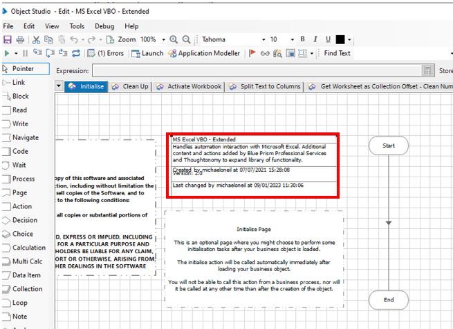

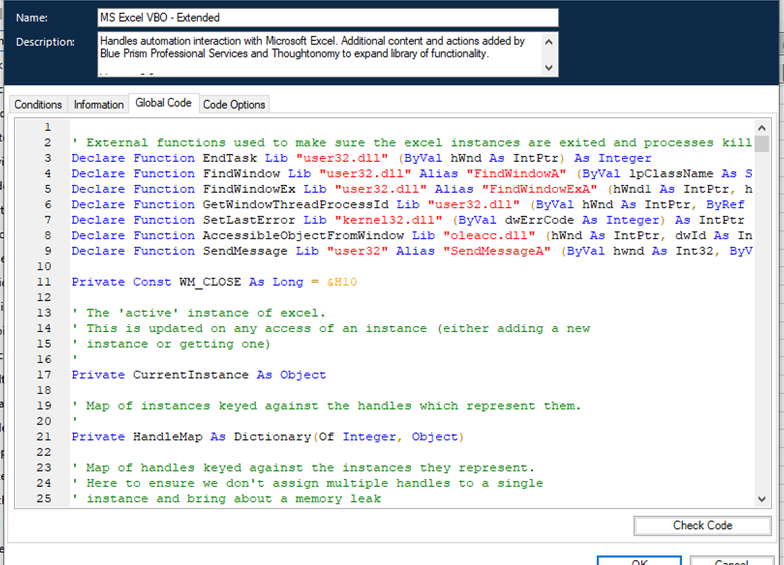

This looks like you could be missing some of the global code for excel actions, I'm assuming you have created a new object for this action and not added an action to the existing excel out the box object? If it is a new object then its likely you could resolve this by adding in all required global code. Open the blueprism standard excel object and on the initialise page double click the  name and comments section (shown in the screenshot below). In the Global code tab select all the code and copy it to the global code on your object. After you have done that go to the code options tab and make sure your object contains all the same dll names as the blue prism object. If there are any missing just add a row and add the one you are missing. Hope this helps 🙂

Hi Michael,
Oops, my bad, global code was not defined.
It works fine now on excel vbo. Thank you for your help!

I have added office.interop.excel and following error occurs..
'DataTable' is an ambiguous reference between 'System.Data.DataTable' and 'Microsoft.Office.Interop.Excel.DataTable'

Hi - you need to add System.Data.DataTable as the reference in initialise as both of the libraries Interop and System.Data have Datatable - you need to specify the compiler to use System.Data.DataTable.
