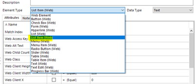

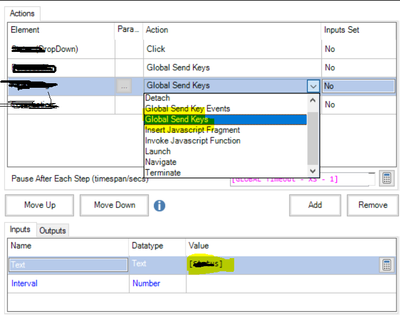

Instead of the 'Select Item' action, have you tried using a Global Send Keys action instead?
If you're still getting the error afterwards, make sure you're validating that 'Element Type' and 'Data Type' in the Application Modeler are populated as expected.
Make the element type as List Item (Web), as per screenshot
and match the attributes as per the need.
In the Navigate try using the Global Send keys and make sure the Combo box is active on screen as per screen shot below,

steven.boggs
