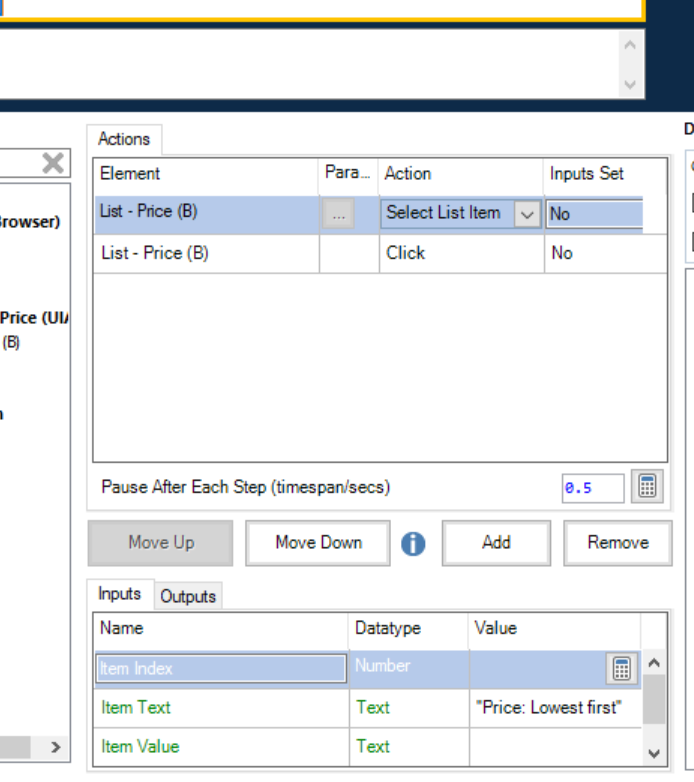

Curious to see if anyone else has run into the same issues we have when using Browser Mode in Chrome while attempting to select items from a dropdown/combo box.
We are seeing time and time again that when spying with Browser Mode we are able to interact with the dropdown - it is able to select the item we've asked (either by text matching or item position) but if the selection in the menu triggers a change on the page, that change isn't happening.  For example - selecting an item in the dropdown then triggers a handful of checkboxes to be marked based on the selection made.  The automation will properly select the menu item, but the page acts as if the selection hasn't been made and that next 'trigger' step isn't happening.
Usually we end up having to perform some sort of UIA mode with mouse clicks and/or its own 'Select Item' option but we've found that it is much less accurate.  We've also tried respying using different characteristics, with no luck.
Granted, some of the sites we are working with are quite outdated, so not sure if this maybe has something to do with the backend code of the HTML itself, but we keep finding ourselves in this position.
Just curious to see if any other devs have run into similar problems and what they have done/attempted to do to work around it.

Yes, its a very common scenario and it happens most of the time while dealing with chrome browser. It's right that you can use UIA mode to perform Global Mouse Click Center and then typing the value via Global send keys. But while performing this step, please make sure to train the bot to read the selected value. This will act as additional check that the selected value is accurate and expected one only.
The other way could be JavaScript trigger i.e. just check what JavaScript function gets triggered at the backend whenever the value gets selected from the dropdown. Then you can select the value using Browser mode and trigger the JavaScript function by using the Navigate stage (just pass the JavaScript function name and Blue prism will trigger it).​
