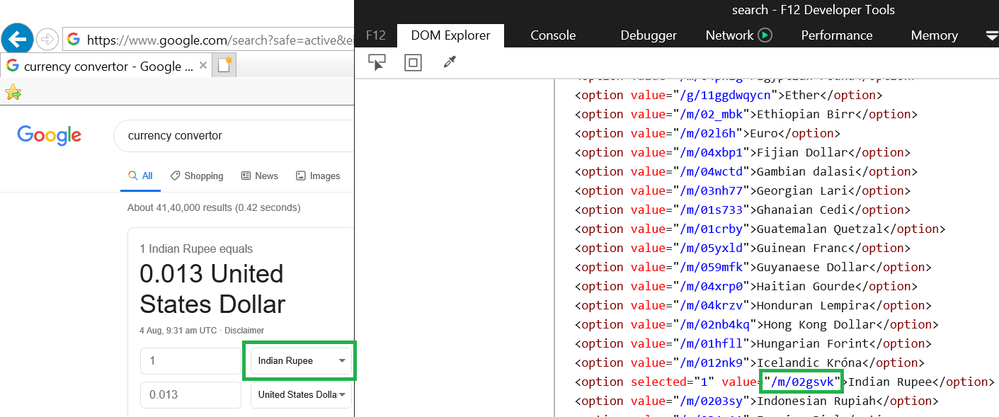

Hi Tim,
I am able to extract the value which is shown in the UI. But not the Item value provided at the back-end of the HTML. Consider the below for example:
I am able to extract "Indian Rupee" using 'GetAllItems' and 'Get Selected Item Text', but I want to extract Item value which is "/m/02gsvk".
