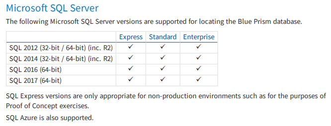

01-03-23 05:36 PM
Blue Prism v6.5.1 is a very old version of the software, and as such, newer versions of SQL Server likely are not tested against it. According to the v6.5 infrastructure documentation (see page 56), the latest version of SQL Server that was tested with it was 2017:
