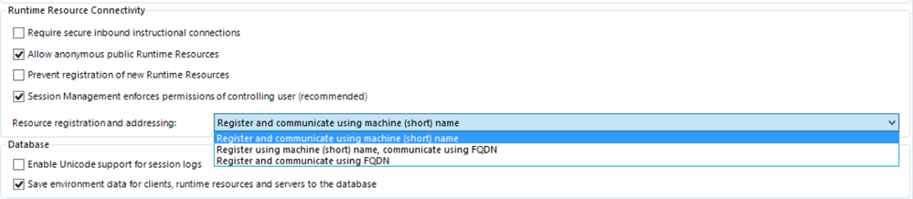

If you specify different port numbers for the two runtimes, then these would appear in the Control room with the port numbers indicated along with the hostname. I couldn't find an option to have the user name displayed along with the hostname. You can find these settings under
System -> System -> Settings -> Runtime Resource Connectivity -> Resource registration and addressing

21-12-21 08:53 AM
Hi Shashank,
Thanks for the reply, I checked for the options in resource registration but there is no option to mention port in Blue Prism 6.8.
