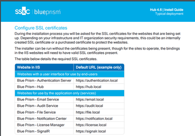

As per the Document the SSL is a Pre-requisite , That may be Self signed or Organization provided.
During the Installation it will ask for the SSL Certificates. May be for the Dev, POC level you may go with Self signed certificates on SSL.
If you are Using same DB Server for DEV and Prod , facing any challenges/ difficulty if Enable SSL. You may go with the Force Encryption Disable while Enabling the SSL. As it won't change or Effect more on All DB servers.
Please find the below URL for the Self signed certificates.
https://docs.blueprism.com/en-US/bundle/blue-prism-hub-platform-4-6/page/installation/install-hub-downloads.htm
