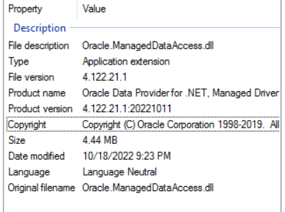

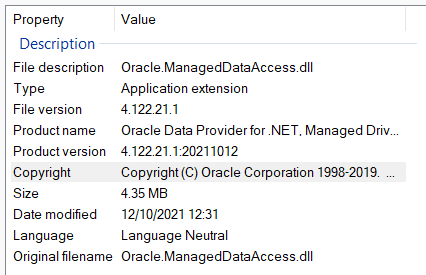

Thank you for taking the time and answering my questions. The version of the asset you have is the 1.1 revision. This is the one that is meant for Oracle 21c (or later), as it has the Bulk update action. Given that you have the asset working fine with your staging database, we have to determine what is different about the connection to your production database. Now, the asset requires the OracleManagedDataAccess.dll to be in the Blue Prism Automate folder, given that you have this working for your staging database can you concur that the dll you have in place for the staging database is in fact the same version (or even the same dll!) as the one for the production DB?
These are the details for the version that was used during development.
What I am trying to determine is, are your production and staging systems the same machines and your production db is just a different database or are the systems totally separate? Can we establish the above before we go any further?

I can confirm that the Oracle.ManagedDataAccess.dll used is the same dll used in both the Staging and Production.
Here's the screenshot of the version of the dll currently being used:
And to answer your other question, yes, both the staging and production database systems are in a complete separate environment as well.
