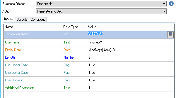

Hi Gavin,
In my experience , Using Bot we can automate the update part for Credential using BP Credential VBO .
Reason behind that is
A credential key must be defined within the blue prism environment
Credential with the specified name must exists
The Credential must be accessible to the running user , process and resources
So you can update the credential , make then valid or in valid or take a list of credential from Credential manager using List action of VBO once the credential is manually created in Credential manager
