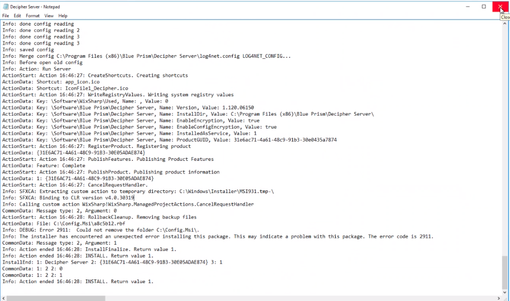

We are installing Decipher on multi tenant platform. All Decipher components are installed on the same server and using SQL Authentication for SQL installation.
We are receiving an error when installing the Decipher Server component. It does create the Decipher Server DB on sql. We do not see NT Authority user.
Does anyone know the cause the installation error. We were able to install all other components without an issue. Our problems are around the Decipher Server installation.

obvious question - do you have sufficient permissions for creating a database under the user you are specifying. I guess the answer might be yes as you are saying that you see Decipher Server DB in MS SQL. I can see in the log file that you ticked to use Encryption. Can you try to run installer without ticking the checkboxes for encryption? It is just to change something to see if it can be the reason.

We did uninstall all components and reinstalled without encryption. We still had the same error. We are trying to install on SQL PaaS instance with SQL authentication. Do you know if the installation will work on SQL PaaS?
