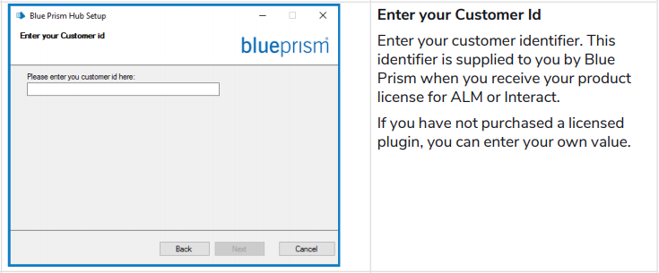

exists a way to change the Customer ID number after that the Hub's installation is completed?
If a write error occured i think that it's possibile to change the mistake and reinsert the correct costomer id.
Thanks u,
Ambrogio Crivelli
