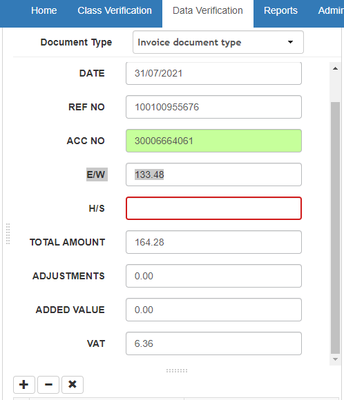

I have now two different issues:
1) when I submit the batches after data verification nothing is received by the 'Decipher - 03 Get Verified Documents' process (Available batch = false)
note that: rabbitMq and decipher services is running - I restarted decipher from IIS - I run DecipherServerConfigurator and apply it
2) I have 10 fields here 8 of them is learned by decipher, how I can make it learn the other 2 fields H/S and ACC NO to automate data verification

20-09-21 01:55 PM
Hi George,
1) Are you using the templated processes to push documents and retrieve the data? Are you using the connection actions before each task? Are you connecting to the same RabbitMQ queue? Can you see the documents pending in the queue in RabbitMQ?
2) That's very difficult to say without seeing the document or the DFD. The main method would be to use sample headers.
3) There is a report on the history of the batches which displays the confidence for each batch. Though it may not be available if you've opted to encrypt your database. There's an update due in the next version to make it available to all configurations.
