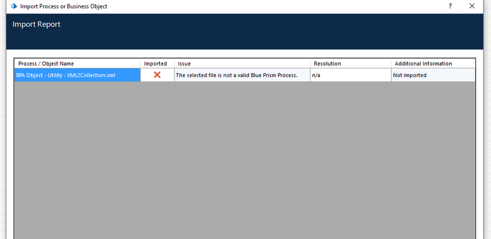

I tried to download and import the VBO BlueprismVBO/BPA Object - Utility - XML2Collection.xml at master · aikudinov/BlueprismVBO · GitHub but the import failed with the below details:
I am using BP 6.10.4, can you share the version which can be imported in this if you already are using it?
Many Thanks

Hi @Manish Rawat
I've attached a copy of the one I have. ​The reason the one you have wasnt imported is because you said it as XML you need to save the text file with the extension .bprelease to save it as  BP compatible import.

Hi @Michael ONeil
Thanks much, It worked :)​
