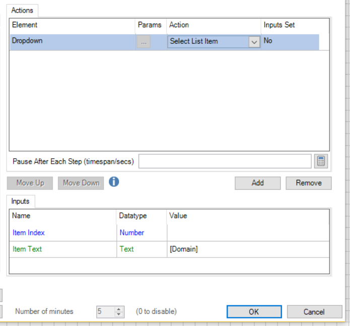

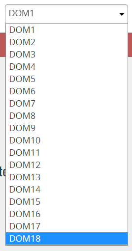

Hi all,
Currently running into problems with the application modeller. I'm aiming to select an item on the drop-down menu on a web-based application (Chrome). This is the complete menu:
I used two navigate steps:
With this being the result:
So I have been able to select the desired element, but it doesn't appear to really 'click' since the page does not load. When I continue with a navigate stage to another button, the drop-down menu automatically 'resets' to DOM1, since DOM13 was never properly selected in the first place.
Am I approaching this correctly? What should I do differently?
Thanks!

Hi Ellen,
I'm going to have to make some assumptions here that it's a pretty standard web-page, with that in mind your approach is correct but sadly in many cases the interaction of a digital worker aren't picked up.
If we are talking a standard website, you normally have a couple of methods that work:
My approach when forced through the UI often centres building a basic logic that underpins why I'm doing something, and then trying to make the robots interaction a bit more human.
Hope this helps,
James
James McLintock
Process Analyst and Developer
- A Global Send Keys/Events of the {ENTER} when you land on the one you want and it doesn't click will often suffice
- Combining your steps into the same action and putting a fair wait stage in-between them can also solve this issue
- A less robust one is to stay on the thing you want for a while and then interact with a standard element on the page, normally meaning the dropdown selects what is selected.
- If none of these work;
- You could look at more unstable Global Send Keys techniques depending on how consistent the website is i.e. make a logical decision and stick by it
- Or some trial and error with focusing, activating and pauses can be helpful
Hope this helps,
James
