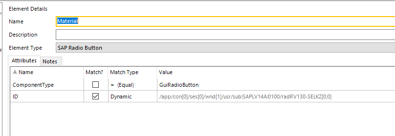

So I have captured the element in Objects and ID was there as attribute properties. Now  while writing action I am using the same element to write with dynamic match type.
Already tried with concatenated Logic but still same issue.
attaching screenshot for your reference.
1) This is the element.
11803.png2)  This is where I am setting the dynamic value
Bhawana Daultani
Perfect!! Try it then:
Dynamic "ID /app/con[0]/ses[0]/wnd[1]/usr/sub:SAPLV14A:0100/radRV130-SELKZ["&[DataItemValue]&",0]&"

It worked.
Thank you for your help.
