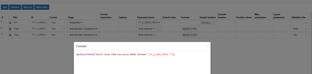

I prepared a document where there is only ZIP Code, I prepared a database having three columns - ZIPCode, State, Town. I createad DFD where I have three fields - ZIPCode, State, Town. For State (and Town) I have an SQLEXEC like this
SQLEXEC(STRJOIN ("SELECT State FROM SourceList WHERE ZIPCode = '", FT_1_USER_FIELD, "'")). When I run a document having ZIPCode 18000 (in the database it maps to Prague and CZE) I am getting in Decipher Boston, MA.
What am I doing wrong?

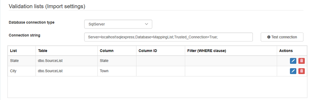

Also check that you have added the dynamic list in the batch type settings. In addition to the database connection string, you have to specify the location of the list in the database.

I have checked Auto-calculate and Dynamic List. I also created database connection string but I do not fully understand the relation of Dynamic list in the batch type settings to the DFD. I thought that this is connected to Validation List column in DFD and not to Formula column. See my settings in the images below.

You are right, the lists defined in the batch type settings are for static lists. The list name column in the DFD binds the static list to that specific field. The entire list is imported to validate against the value generated by the OCR engine.
For dynamic lists, it looks like you only need to specify the import connection string. So, you should not need to specify lists in the batch settings or the DFD.
Try:
SQLEXEC(STRJOIN ("SELECT [State] FROM [SourceList] WHERE [ZIPCode] = '", FT_1_USER_FIELD, "'"))
