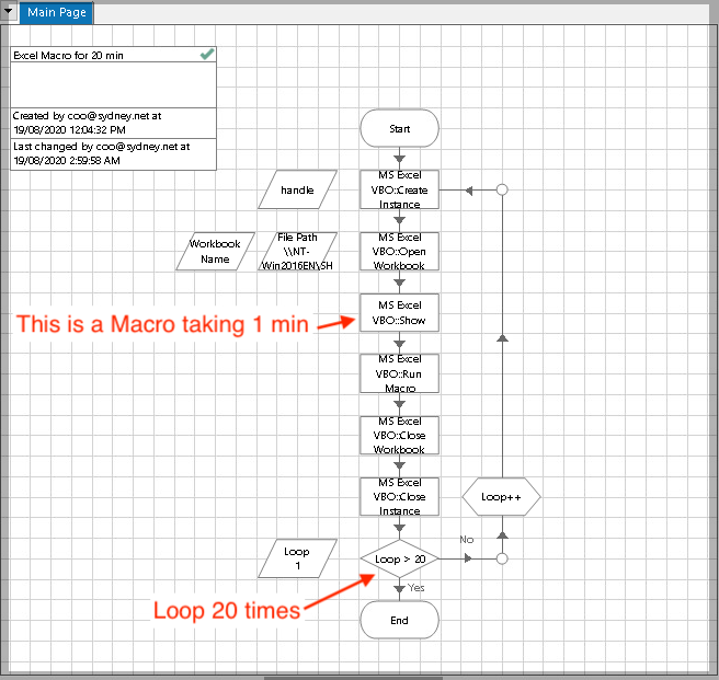

I crated a sample process based on your information. But the process worked without any issue.
The following image is my process design.

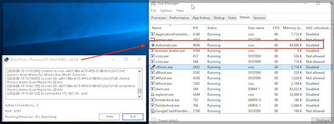

And the following is the screenshot when the process was completed. The runtime resource was still running and I don't see any memory issue.

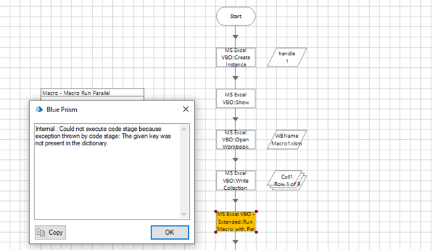

@ewilson - I downloaded this VBO some time back, however there are few things --
1) The action run macro with parallel thread is not published, not sure if its ready
2) It is not even mentioned in pdf guide for this VBO
3) I published it on my own and tried using it it gave me an error, please find attached the screenshot
4) How I assume this action is intended to work is - I will have to code a msgbox in my maco at end - something like automation completed, this action will run macro and it waits for that message box. If message box is displayed before timeout, action will click ok on message box and move to next stage else will give exception if no message box ​is displayed within timeout. Also I am not sure what it will do in case of any internal error within excel macro which shows a error box. How will it differentiate between completion popup and any internal excel error popup?
