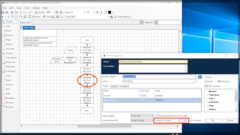

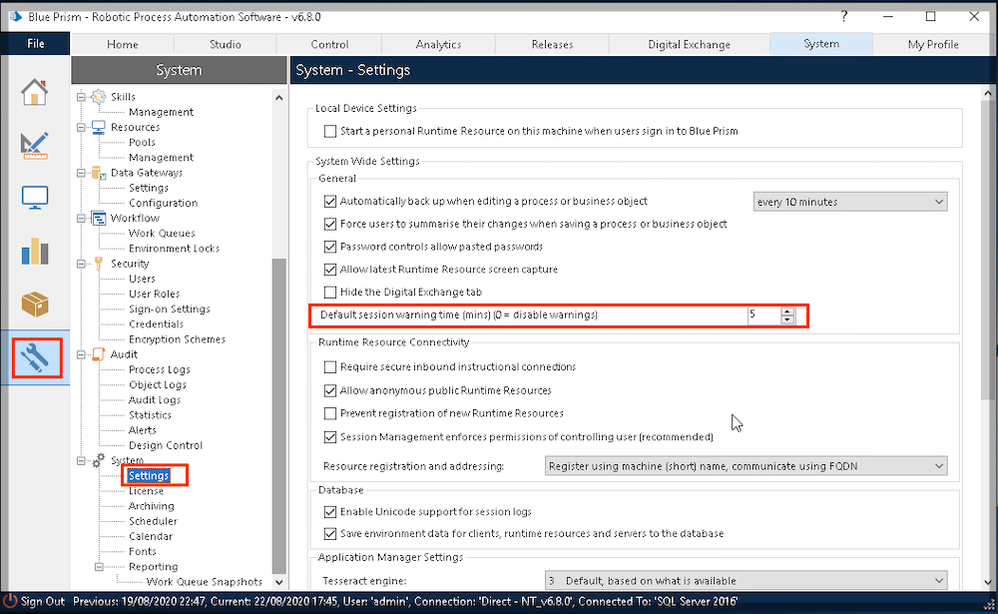

You can change the timeout value from 2 locations
  1. System - Settings:
  2. Each Stage:
FYI,
