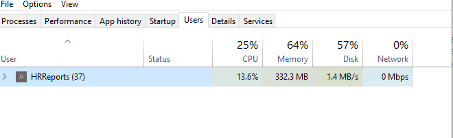

Thanks Sashi.
I tried doing that but didnt worked. it says only one user logged in which is the expected user
12968.pngAnd the error is still there. Any thoughts ?

Thanks  Akash. I did experiment and   encapsulated the file path in Open workbook VBO as an environment variable and it worked. Kinda weird but got the job done. Thanks for the help Cheers 🙂
