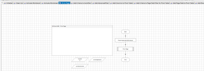

Hi @MatthewBelia1 and @dvashish
You can create new action, Here I named as Fit to page and copy" Check instance and workbook" step from Activate worksheet action as in the screenshot.
There are no output parameters for this action.

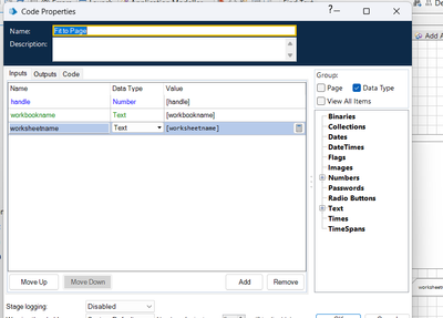

In the code stage use below code. you can tweak based on your requirement
Dim ws As Object = GetWorksheet(handle, workbookName, worksheetName, False)
Dim sheetExists As Boolean = ws IsNot Nothing
' If the worksheet exists, apply the fit to page setup
If sheetExists Then
ws.PageSetup.Zoom = False ' Disable Zoom to enable FitToPages
ws.PageSetup.FitToPagesWide = 1 ' Fit to one page wide
ws.PageSetup.FitToPagesTall = 1 ' Fit to one page tall
End If
