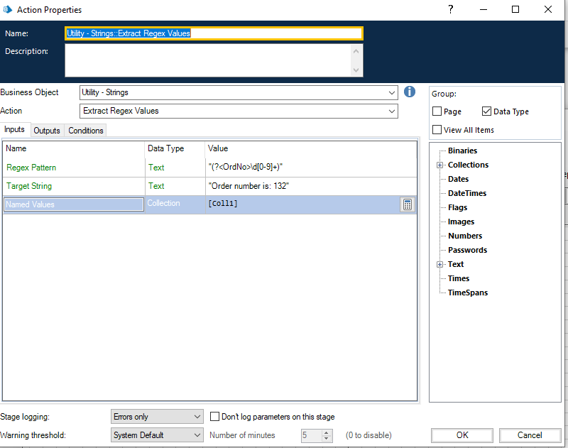

Hello @shaun reed, if your text has variable number length, you can use Utility String VBO "Extract Regex Values" action. This will give you the extracted value of however many numbers from your string in a collection. The Coll1 collection should have 2 fields Name and Value. In the Initial Value add one row, where Name will have OrdNo and keep value blank. Hope this helps.
