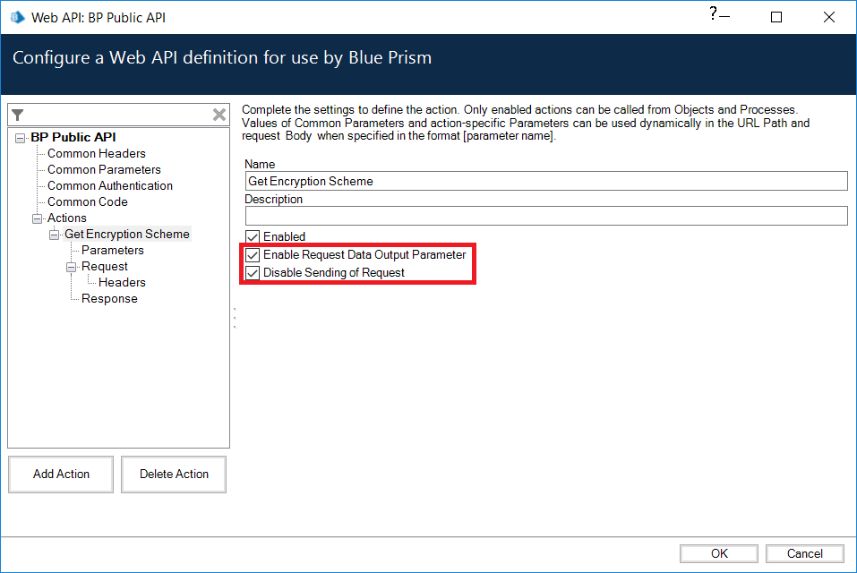

See below for an example of the use of placeholder of what I meant. I have also attached a BP release with the example for your information. Note that you may not be able to run this in your environment.
To troubleshoot your request, you can consider enable the following two options in your request. This will expose the full request in the way how Blue Prism will send it but not actually sending it to the host. In your process/object, kindly expose these data items to see the results. In this way, you can inspect how the placeholder you created would impact your web request.
Hope this helps.
