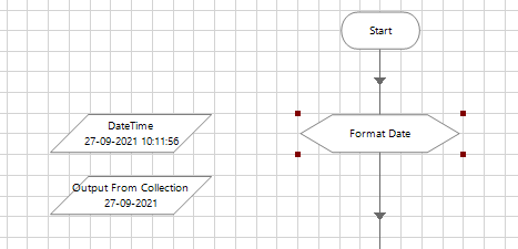

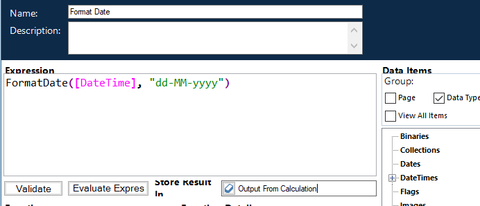

Hi, Tejas you can do one workaround if the Datetime data item has value in it.
1.In a calculation stage, try to convert it into some date- for ex - dd-MM-yyyy
2, If it has the value, it will give a value in the output of the calculation stage, if not it will be empty.
3.If it's empty then your Datetime data item is also empty.
Hope this helps.
Murali

Carl__Carter
Hi Tejaskumar,
You can use the IsDateTime() function in a Decision or Calculation stage, to test if the data item contains a datetime value.
Hope this helps.
Carl Carter
Senior Developer
Thanks, Murali & Carl. Both solutions are working very fine and as expected. Thanks for the quick help.
