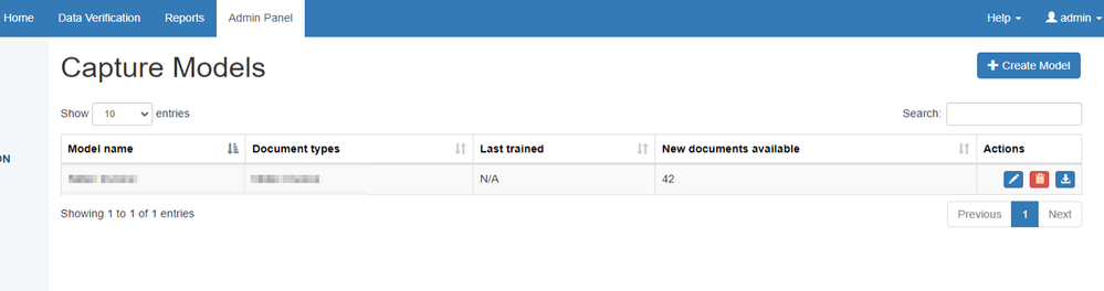

We have a Batch Type with ML enabled. We have trained multiple documents, but under the Capture Models panel, it keeps showing N/A in Last Trained section. How can we set Decipher to automatically keep training the ML model as the user verifies the documents?
Basically, we want to have the ML model keep learning as each invoice is verified in the Data Verification tab by user. How to achieve this, please advise.

You generally don't want the Capture model to update after every document you process, for a few reasons:
The native rules-based ML model (always on) is updated after each document and can provide a high degree of accuracy for most supported documents. The Capture ML is designed to add an extra layer of intelligence, improving an already well trained model. If your document confidence isn't good without the Capture model, it won't substantially improve with it.
There's additional info in the Best Practice guide, see the Machine Learning section at the bottom.
Also check out the Training Models overview.
