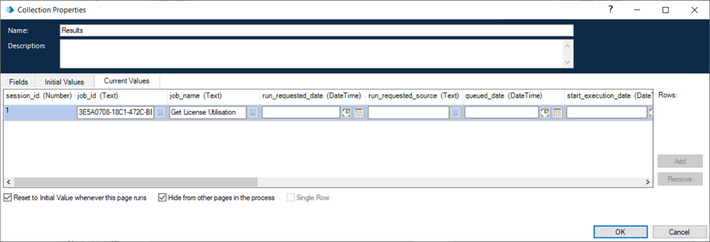

In my testing, I am able to obtain a collection like below:
Hope this helps.
