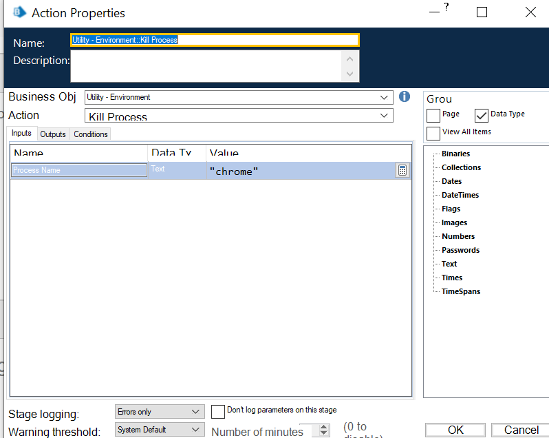

Simple use "Utility -Environment" --> Kill process with "chrome" as input.

You can achieve this using below method.
1.using navigate stage - select root element in navigate stage and select terminate from drop down action.
2.using action stage - select utility Environment vbo and select action kill process ( Parameter will be "Chrome")

Can you please share a screenshot of your "kill process" properties?

Sorry, can't share the screenshots due to security concern. Let me brief the issue bit more.
We can able to close the Chrome instance in our PROD environment, but in DEV the Kill Process is not working. It's not throwing any error, it's just crossing the stage without closing the Chrome.
