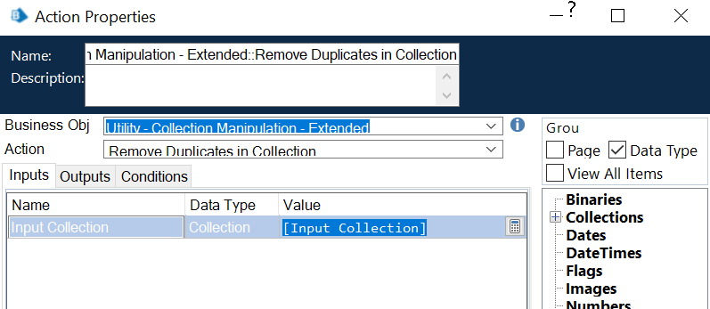

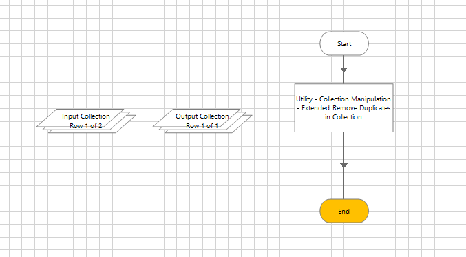

Hi @NafizZainal
Kindly go with the code stage rather than looping the collections as it might take longer iteration time when the collections are fully loaded, as suggested above by @Neeraj Kumar and you can find the code by Emerson Ferreira in the above discussion.
Its a One liner code to be specific ( Collection_Out=Collection_In.DefaultView.ToTable(true) ) , follow this approach if you are facing any difficulties implementing above approaches:

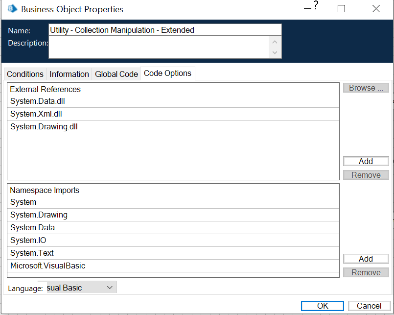

Process :
Object : Add an Action in one of your existing collection manipulation extended objects or create a new object and check the required Dll and Namespaes in the Initialize page> code options:
Add an Action page and add input and output collection and write below code:
