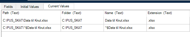

Hi Kristian
There are 2 ways you can handle this issue, firstly you can set your process to attach to the current handle and then exit the current instance of excel which will close the application. Alternatively you can use the VBO Utility - Environment and the Action Read Memory stats in which you can pass in the names of the applications you are searching for to identify if they are open. If there are any instances of excel it will output to a collection and then you can count the rows in the output and if there are any rows you know the application is open and you can use a decision stage here, then use the Utility-Environment and action Kill process to end the application which will allow you to then create your new instance and open your workbook. Example of this is below, hope this helps 🙂
