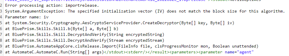

I am importing a BP Relase File from service now(excute importrelease through bat). But I am getting below error,
An error occurred while attempting to import the release:
Error processing action: importrelease.
System.ArgumentException: The specified initialization vector (IV) does not match the block size for this algorithm.
Parameter name: iv
My App Version: 7.0.2
Kindly Help.

Hello @yaoli,
This appears to be an issue related to the encryption used on the skill file. Which ServiceNow asset were you trying to import, or did you experience this on multiple?

Hello @ewilson,
thank for you response.
I call bat in snow to import the release file into blue prism.
So far, this error has only occurred once.
