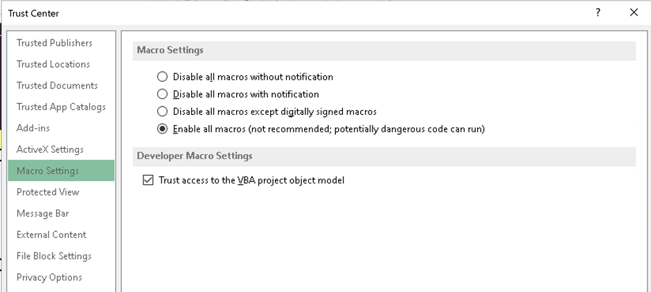

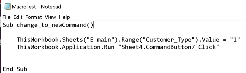

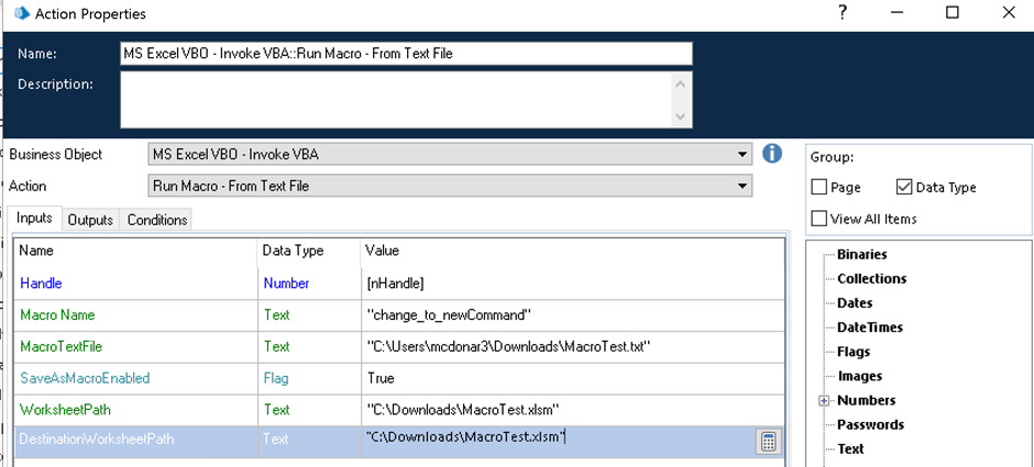

Thanks Amlan Sahoo, unfortunately I'm getting the error of "The macro may not be available in this workbook or all macros may be disabled"
I've checked that Macros are enabled in Excel so I think it's a different issue, please see the below for the various settings and code I'm trying to run.
